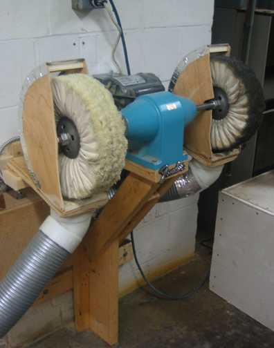

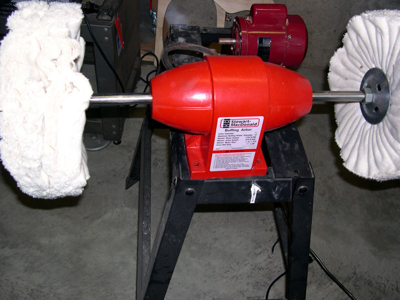

Hmm, great minds must think alike! Is this what you are referring to? I have this old stand but wasn't sure it would be sturdy enough to take the torque of the buffer and motor without walking away on me. So the weight of the 3/4 wood is enough to keep it in place? That would be the way to go if it's sturdy enough. I guess I could also bolt to the floor if need be, but I think I'll try your way first.

Was using a pedestal base with motor behind. But since you want to hold the guitar to the underside of the wheels, the pedestal gets in the way. Now it is bolted to the wall with a riser that brings the base of the buffer about 8" out from the wall, and motor mounted above. Much better. Got the idea from Bruce Sexauer.

Hoods and dust collection are optional, but a buffing arbor is really best
mounted to it's own pedestal, rather than on a work bench. A frame of 2x6's
bolted to the wall will work just fine.

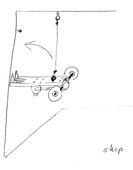

Here is an idea that popped into my head as this thread progressed. You don't need a buffer every day. And it's fairly big as tools go. Mine takes up valuable real estate. With a wall attachment on say a 2 by 8, a cable attachment, maybe with two cables rather than just one for more stability, this thing could be slapped back up against the wall when not in use and latched in place. The motor could also be hinged under the 2 by 8 giving you your belt tension automatically.
PostPosted: Mon Aug 27, 2007 3:32 am
Posts: 993
Bruce, that looks like a great idea and would really save shop space, however I'm not seeing how that setup would tension the belt. If I'm understanding you correctly, the motor and arbor are both bolted to the 2x8. Let's assume your belt stretches and wears and you need to adjust the tension. Wouldn't you have to remove the motor and remount to give the proper tension? Or, are the hinges you're referring to not the hinges on the wall but some type of hinge between the motor and mounting board? Ah, I see said the blind man (then he picked up his hammer and saw). What type of hinge did you use? I'm headed off to Ace hardware as soon as you respond.

My rig is like the one in John's picture except the "deck" is larger to get it further away from the wall. The deck is mounted to the wall on hinges, (the hinges are attached to a skookum 2X4 which is screwed to four studs... Overkill probably) so the whole thing hinges up, out of the way. A single light chain supports the deck in the working position.

Yes, John, I was talking about mounting the motor on a hinged plate under the 2 by 8. Sorry, the drawing is a bit crude.
Cable is cheap and so are the clamps and eyebolts and screweyes. I do think I'd do a couple or triangulate off the wall someway, just to make the device very stable. Of course, two cables make more stuff to avoid when buffing, so a wider back panel than a two by eight might work a bit better.
